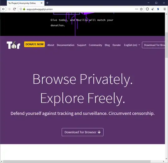

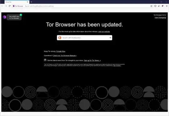

When I resize the Tor Browser window the webpage doesn't fill the entire screen. I think that this is a problem with Firefox. How do I fix this? Even the homepage doesn't fill the entire window The Tor Project website renders incorrectly
This is intentional as it is a way to protect against finger printing your browser window based on the dimensions of going full screen. It reduces the websites ability to track you based on the window dimensions.
