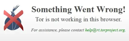

  • I've taken the .xpi file from the Tor Browser Bundle default profile and installed it to Firefox. However, when I run Firefox with it, I get the following screen: Something Went Wrong!

This might be a dumb question, but are you actually running tor? I don't think torbutton itself does this, you need something like Torlauncher to run tor as a standalon service by itself and then you proxy your browser through it.
Edit: I should add, to simplify things you could run tor using the full tor browser bundle and then just (close the torbrowser and) set your customized firefox's proxy settings to run tor.
I should note that the Torrify HOWTO strongly recommends against this sort of setup for security reasons. The torbrowser has had a few years of vetting and bugfixes to acheive the kind of security it has today. If you really need webdriver though, just know in advance that you are likely sacrificing security as a tradeoff for functionality.
