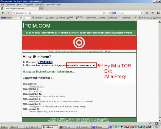

Many exit nodes are not anonym. It says "Hi I'm a Proxy Or Hi I'm a Tor Exit Node on host name". Here is a test site: http://ipcim.com/hu/.
Host names:
  • TOR-EXIT.CYLAB.CMU.EDU
  • sipb-tor.mit.edu
  • wannabe.torservers.net

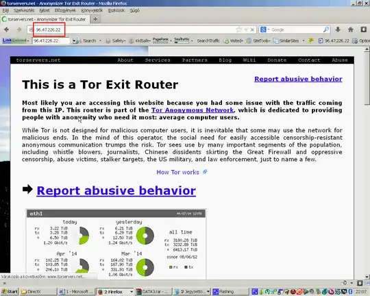

So websites can detect you use Tor, and this is the first problem. The second problem some entry nodes says (the first proxy you connect directly the 3 hop) says too I'm a Tor exit.So your Internet service provider can detect you use Tor. When you type this tor exits IP address the Tor browser this show you a site what tell you this is a tor exit node.

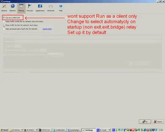

I have a idea how fix this problem. The big problem on Tor network was the „Run as Client only function”. This 'Run as Client only function' I would not be supported. Who uses the Tor network be required run Exit, non-exit or bridge relay. And I have to replace Vidalia/sharing “Run as Client only” function to automatically select Exit, non-exit or bridge relay function. I'm telling everyone who use the Tor network required to participate in the operation also. The result more exit nodes more anonymity and more users more secure hops. I do not agree that some users can only get and give nothing. It's just like stealing. Be required in the future all Tor users run select Exit, non-exit or bridge relay. Those who do not like this look for another service.
Much more Exit Nodes need what run normal users who use tor client. Normal users who run Exit Nodes won't show hey i'm a proxy. And Those who do not like it do not use.
I know it's not your fault, this failure of Special users who run Exit Relays and advertises in host name and IP address im a Proxy service or im a tor exit node. So more Exit Nodes needed what running the normal users so you can connect normal users.Normal users show you normal Internet providers and normal host names.
Hy IM A TOR EXIT
just an idea Change "Run as Client" funktion to select auto on startup by default (Non exit,Exit,or bridge) relay.And wont support use as only Client. enter image description here

When running an exit node, it is highly recommended to make it as clear as possible that it is an exit node. This helps the operator deal with DMCA notifications and abuse reports and the like.
Further more, it is impossible for any relay, exit or non-exit, to hide the fact that they are a relay. The list of all relays and their flags is publicly available. This is even necessary for the network to function, as clients need to pick relays for their circuits.
Your ISP can tell that you use Tor (unless maybe when you use obfuscated bridges), and your ISP definitely knows when you run a relay. They even know who your entry guard node is. But they don't know where you exit from and to, and they can't decrypt your traffic.
If you need the anonymity of Tor to protect you from censorship, there is a good chance that you are not in the position to run a relay.
Edit to add: Tips for Running an Exit Node with Minimal Harassment <-- this details all the recommendations for running a Tor exit node.
