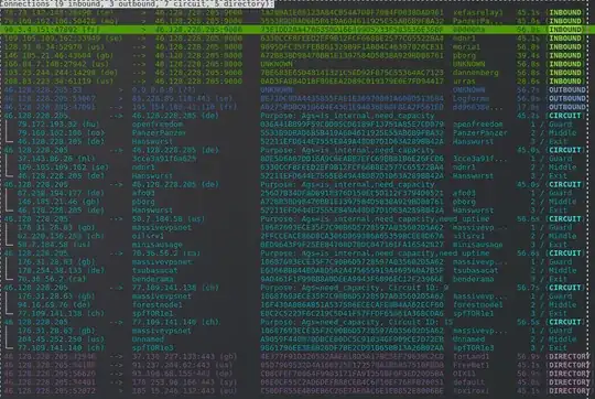

Arm is giving me the warning, that the torrc differs from what tor's using. armwarning
When I perform a SIGHUP to reload the torrc, my relay isn't an exit any longer.
sighub performed
Can i trust the arm connection list?

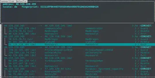

Edit: I added the option DisableDebuggerAttachement 0 and got that list. The connections look kinda scary for being a relay.. enter image description here

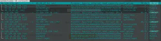

Hey I wanted to close that issue. The main problem was that I confused the EXIT of the internal circuit with the EXIT of the Tor network. 2 tickets exist to clarify that UX problem in ARM. 6430 and 12956.
I think for non-general-purpose circuits, we should call that third hop something else. I'm open to suggestions -- one option would be to just call the last hop on a non-exit circuit "Middle" also. Another option would be to call it "Internal".
There exist one more stackexchange question too.
In conclusion, what I have seen is that TOR made internal circuits and called me the EXIT of them. That is not really a problem because I am not an EXIT of the Tor network itself.
