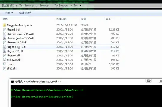

I have installed TBB, but I need use the command line tor. TBB is working, and some project use python to start tor is also working(such as this https://github.com/realgam3/pymultitor)
Find the location,
tor -h, show nothing:
parameter found from https://www.torproject.org/docs/tor-manual.html.en.
If I just type tor, can see it run in backgroud(in task manager). But I want to see the detail.

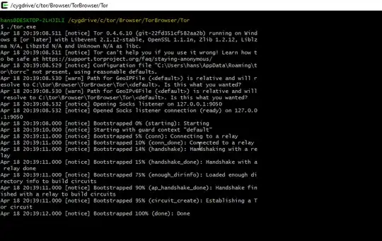

another solution is to just run tor.exe from Cygwin: enter image description here
i don't know why exactly, but Cygwin has no problem reading the output from tor.exe
