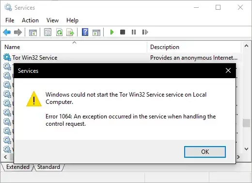

Goal: start the tor service on Windows 10 with specified torrc.
My attempt:
1 step. tor --service install -options -f C:\TorBrowser\torrc
2 step. Trying to start the service... I get the error.
Error 1064

When I try to run C:\TorBrowser\Browser\TorBrowser\Tor>tor.exe -f C:\TorBrowser\torrc the process tor.exe starts and dies in ~one second.(I looked in the Task Manager.)
The similar Tor ticket.
The only way to create a running tor service for a relay is to use the "sc create..." in cmd command line as irc#tor suggested. So this is how it works: sc create "Tor Win32 Service" binPath= "\"C:\tornou\Tor\tor.exe\" --nt-service -f \"C:/tornou/Data/Tor/torrc\""
I tried this solution. The problem remains, the service does not start (with Error 1064).
Any help is welcome!

The log line is a relative path, within Tor Browser this normally works because it is careful about the directory it is in when it interprets the relative path.
Log notice file TorBrowser/Tor/notice.log
You should instead make it an absolute path instead to ensure it's opened in the correct location. e.g.:
Log notice file C:\TorBrowser\Browser\TorBrowser\Tor\notice.log
