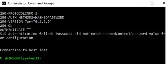

Still getting:
250-PROTOCOLINFO 1
250-AUTH METHODS=HASHEDPASSWORD
250-VERSION Tor="0.2.9.9"
250 OK

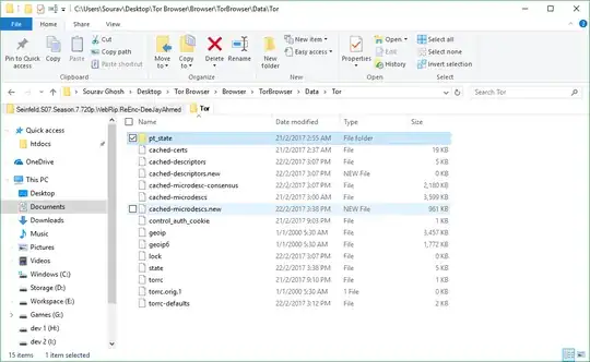

Screenshot of Tor data directory:
screenshot tor data directory
I have also tried AUTHENTICATE ""but failed.
