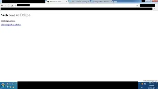

here is what i am getting after accessing ip_address in browser.
Currently flow is :
nginx (port 80) -> 127.0.0.1:8123 (polipo) -> tor (socks proxy on port 9050)
if i stop polipo and use socat as suggested by other answer, i can access example.onion by going to my ip_address.

from web browser trying to access ip_address
