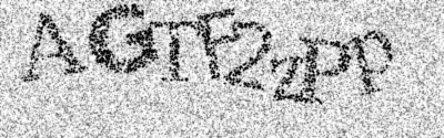

Example CAPTCHA for reference:
Any captcha system can be broken by paying people.
The captcha has been attacked in the past by a nationstate adversary.
The captcha isn't critical to the security of Tor, it does present problems for censorship circumvention.
Breaking it would net you a subset of the bridges on bridgedb, it is partitioned so that a break on any one of the distribution methods will not compromise the entire set of bridges.
There are infact many (and cheaper) ways to discover bridges with less work and effort, see for example this report by arma.
So "ispo (sic) facto we're all being spied on" doesn't hold. The previous "fact" (the captcha is defeatable) does not lead to the conclusion that we're being spied on, merely that powerful adversaries can use a largely redundant method to discover some of the bridgedb bridges.
The captchas purpose is limited, and it's limitations well acknowledged. Worrying about the difficulty of the captcha is bikeshedding, at least against NSA level adversaries.
I'm not even going to waste time trying to deconstruct some of the other faulty logic and assumptions in your question. Even if they were right, the result is mostly irrelevant.
