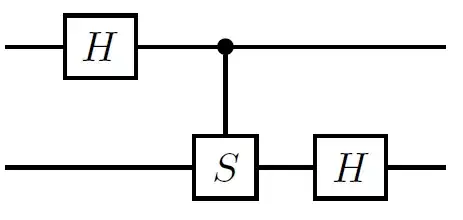

The best way to resolve this is with an example. So, take the simplest example: the Fourier transform on two qubits. The circuit looks like this:
This is easy to analyse because there's only one entangling gate: the controlled-$S$. Any single-qubit gates that come after it do not affect entanglement. Now, if controlled-$S$ acted on an input of $|+\rangle|+\rangle$, it would create entanglement. So, we can work backwards: if I input $(H\otimes I)|+\rangle|+\rangle=|0+\rangle$ to the circuit, the output must be entangled. Separable input yields entangled output, so the circuit is entangling.
