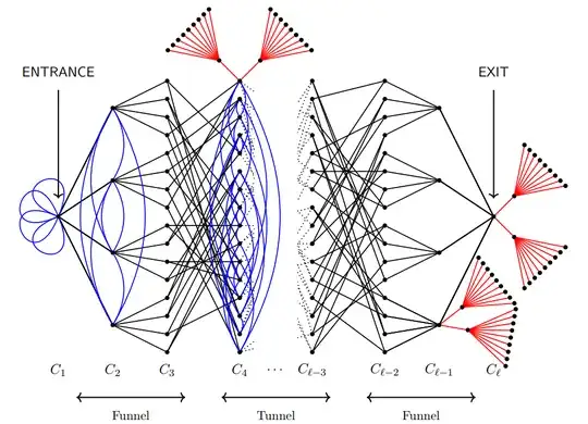

Gilyén and Vazirani, building on the recent breakthrough of Hastings, give a (sub)-exponential separation for a quantum adiabatic algorithm with no sign problem. They design a graph that can be traversed easily with a quantum adiabatic algorithm but gets stuck in a bunch of dead ends classically, and further can't recognize when it's walking around in a loop. That is, their graph was specifically designed to frustrate classical algorithms.
They hint that the quantum improvement comes from (A) topological properties of the graph, (B) as well as $\ell_1$ sampling classically vs. $\ell_2$ sampling quantumly. See here for a nice video.
To my naivety, neither the topological properties of the graph nor the difference in $\ell_2$ vs. $\ell_1$ sampling appear to have much to do with the kind of structure at play in Shor's algorithm.

I really like how haphazard their FIG. 1 looks - there's no structure that jumps out!
FIG. 1 of Gilyen Vazirani
