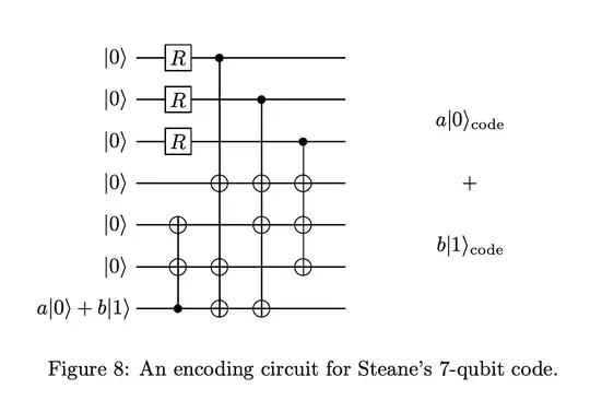

As narrowed down in the comments, the focus of my answer is on the process of encoding an arbitrary state, so that when an error occurs it may be corrected. (Source for the diagrams / info)
My understanding is that the Hamming parity check matrix is used to determine the encoding unitary. Consider the [[7, 1, 3]] Steane code, which has the following parity matrix:
Parity matrix
And the associated circuit:
Circuit for encoding scheme of [[7, 1, 3]]
So, the first three qubits correspond with the first three columns of the parity check matrix. This enables us to yield a superposition where the first three qubits range from 0-3, and the last four qubits have maintained their parity.
One open question for me remains, namely in the necessity for the repetition code to begin with. Answers/edits on this front appreciated!
