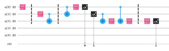

Trying quantum teleportation in https://github.com/Qiskit/qiskit-textbook/blob/master/content/ch-algorithms/teleportation.ipynb
Succesful runs in 'qasm_simulator', but when switching to IBMQBackend('ibmqx2') I get IBMQJobFailError
see circuit
holmen
The error is caused by appending gates onto qubits following a measurement. On qubit 1 and qubit 0, you attach a cx gate after a measurementhas already been placed. This will compile on the simulator, but it is not something that is supported on the real hardware.
You should put measurement after all quantum gates. According to the theory, there is no difference whether gates (in this case CNOTs) are controlled by qubits or classical bits. I encountered the same problem, see solution here.
