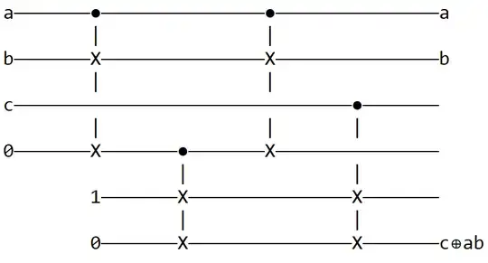

Even though this seems to be a much asked basic question, I couldn't find a reputed answer to this:
  • Implement a 3-qubit Toffoli gate using 3-qubit Fredkin gates.
The best I could do was using 4 gates to give
  1. Can we use less than 4 gates?
  2. In the above circuit how to get rid of the garbage values?(I have heard they are bad for interference)
I am new to quantum computing so please correct me if I am asking something that doesn't make sense.

It's not possible to implement a Toffoli using only Fredkin gates, because Fredkin gates preserve the number of 1s in the state while Toffolis do not.
