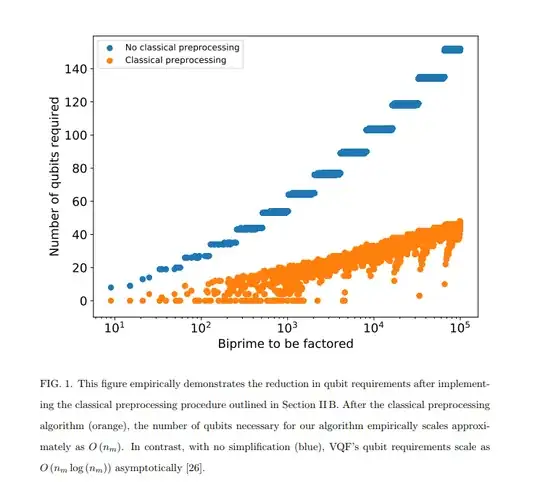

The picture and that other answer refer to Eric R. Anschuetz, Jonathan P. Olson, Alán Aspuru-Guzik, Yudong Cao's Variational Quantum Factoring (arXiv:808.08927, Aug 2018). That reduces factorization to a combinatorial problem with number of unknowns proportional to the bit length of the factors. I find nothing suggesting the preprocessing makes that sublinear in the general case, and conclude that Variational Quantum Factoring is exponential in the bit length of $n$, thus essentially pointless since we have sub-exponential algorithms for factorization on classical computers.
