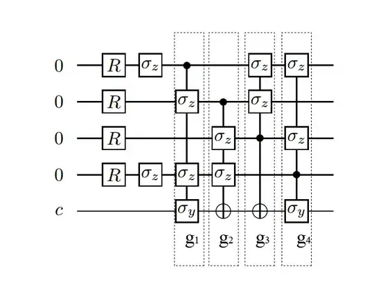

Further, as in page 35 in Gottesman's paper, the encoding circuit can also be constructed through stabilizer generators. He illustrated the encoding circuit of the $[5,1,3]$ code, whose stabilizer generators are $g_1=Y_1Z_2Z_4Y_5$, $g_2=X_2Z_3Z_4X_5$, $g_3=Z_1Z_2X_3X_5$, $g_4=Z_1Z_3Y_4Y_5$.
So I think the encoding circuit of three-qubit bit-flip code can also be constructed by its stabilizer generators $Z_1Z_2$ and $Z_2Z_3$ as shown below.
But in this way the circuit is different from the one in the first picture and I do not think this is right.

The general idea behind 'using' the stabilizers to encode a codestate into a set of (data) qubits is that you perform the stabilizer measurements to project the state of said data qubits to the eigenspaces of the stabilizer generators. To perform these stabilizer measurements, one makes use of an ancilla qubit. In your second picture (on the $[5,1,3]$ code), this is the qubit labeled $|c\rangle$. It is not a data qubit. Actually, in that picture, only four of the five data qubits are depicted.
The text that I linked has a clear explanation on how to perform these measurements. The general idea behind these measurements is that we measure only the ancilla; the measurement outcomes are then associated with the $+1$ and $-1$ eigenspaces of the stabilizer generators.
In your last picture, you show three qubits, which I expect you to mean to be the three data qubits of the bit-flip code. Therefore, there is no ancilla in play here, and this is not a correct picture. You should add one extra qubit, prepare that in the $|+\rangle$ state, and then perform a controlled $Z$ operation to the first and second data qubit. Upon measurement of the ancilla in the $X$ basis, you will have mapped to either subspace of the $Z_{1}Z_{2}I_{3}$ generator. I refer to the aforementioned text for further explanation (I can repeat that here but I think you can really benefit from reading that text).

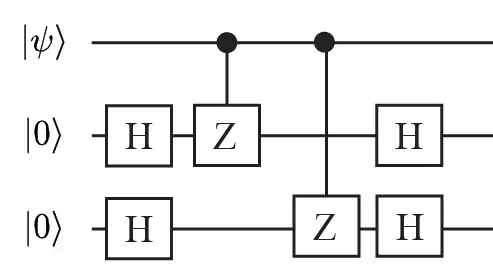

I think this circuit performed by generators $Z_1Z_2$ and $Z_1Z_3$ works.
When $|\psi\rangle=|0\rangle$, it can have the logical state $|000\rangle$; and when $|\psi\rangle=|1\rangle$ the logical state is $|111\rangle$.
