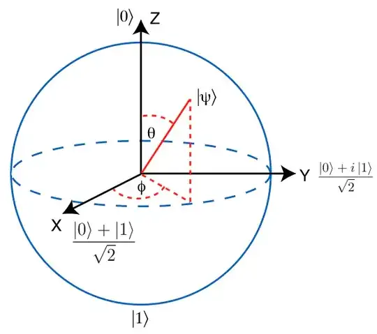

Given a state $\ket{\alpha}$, $\ket{\alpha_{\perp}}$ is its orthogonal state. Writing the states as vectors, the two vectors are orthogonal. It is true that in a Euclidean vector space of dimension $n \geq 3$ (3D space, if you will), a vector has infinitely many orthogonal vectors. In the case of a 1-qubit state, however, we're actually in the $n = 2$ case! In geometric terms, we're in 2D space. This means that we actually have only two vectors that are orthogonal to the vector in question.
To know which one to choose, we have to refer to the Bloch sphere representation of 1-qubit bases.
Bloch sphere, named after physicist Felix Bloch
On the Bloch sphere, two orthogonal vectors are colinear. To find an orthogonal vector of another vector in order to form a basis, we just take the vector obtained by central symmetry. For instance, in the above figure, if we take $\ket{\psi}$ defined by the angles $\theta$ and $\phi$ as the vector, the other vector $\ket{\psi_{\perp}}$ will be defined by the angles $\theta + \pi$ and $\phi + \pi$.
Now as to what $\ket{\alpha}$ with $\alpha = \frac{\pi}{4}$, I believe it means a vector with $\theta = \frac{\pi}{4}$, as the $\phi$ angle is just responsible for a phase constant and does not affect measurement. In short, pick any vector with $\theta = \frac{\pi}{4}$, then find its orthogonal vector by central symmetry.
