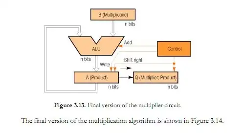

You might find this analogy helpful: the development of quantum algorithms is still in the Booth's multiplication algorithm stage; we haven't quite reached dynamic programming or backtracking. You'll find that most textbooks explain the Booth's algorithm using the following circuit.
Multiplier circuit
That is in fact, the method in which the multiplication logic is implemented in most modern processors (with some minor modifications depending on the version). However, this kind of representation quickly becomes tedious when you move to on algorithmic techniques like looping and recursion which may involve multiple multiplication and division steps, among others. It would be crazy for textbooks to explain more advanced algorithms using hardware-level implementations like this. Not to mention that the basic hardware circuitries vary with the processor. If you've ever done assembly language programming this should resonate.
Classical algorithm textbooks like the CLRS evade this problem by framing the algorithms without any particular processor in mind. The basic algorithmic procedures like addition, multiplication, looping, etc. are all considered as black boxes. If you're interested to see the processor-specific implementation of a CLRS algorithm you could certainly write it up in some high-level language like C and then convert it to assembly. Fortunately, compilers do that tedious conversion on our behalf!
