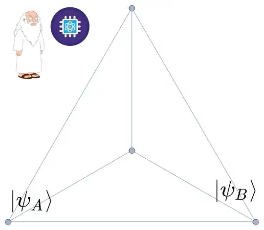

To give you an example, at the last Qiskit Camp I was part of a team that implemented some Groverian Iterations in an Algorithm which as an input took positions on a complete graph.
The repository is here.
So if we want to encode for example two walkers on the graph below, since it has 4 vertices we require 2 qubits to encode the position of each walker. Thus our input will be some state using these 4 qubits. The setting for the problem. In our case we Hadamarded over all the qubits to distribute the walkers over the whole graph evenly before iteration. This you could say was our state preparation.
Take Home Message Think about how to encode your problem in terms of qubits. This will then allow you to think about what your algorithm is going to act on and so what your input will be and what registers you need and so on.
