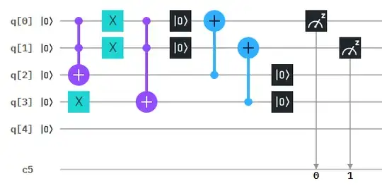

I tried to implement your transformation on IBM Q. Here is the result: Circuit
Input is $|00\rangle$ in this case. You can set input values by application of $X$ gates on q-bits $|q0\rangle$ and $|q1\rangle$.
Please note that this circuit run on a simulator only as reset gate has not been implemented on real IBM Q quantum hardware. But it is possible to simply measure $|q2\rangle$ and $|q3\rangle$. In that case your transformation become reversible.
