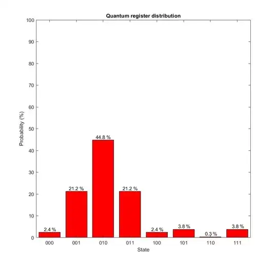

>> quantumComputer(circ,[1 2 3],regs_rev)
ans =
   0.0111 + 0.1555i
  -0.4009 + 0.2265i
   0.3923 - 0.5422i
   0.3405 - 0.3100i
  -0.1511 + 0.0381i
  -0.1343 - 0.1412i
   0.0346 - 0.0478i
  -0.0921 - 0.1717i
Probability Dist
