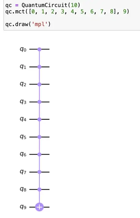

You don't need to use any ancillas at all. Just add in the controls as a list and a target and you should be good.
Take this as an example of 9 control bits
