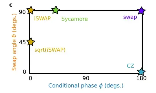

The two-qubit Sycamore gates are described in the Supplementary Information paper for example on pp. 13 and 14.
See FIG. S10 above, wherein the gates are described as an $\mathsf{iSWAP}$ (imaginary swap) combined with a small phase for $\mathsf{CZ}$ (controlled Z). They put their Sycamore gates (green stars) closer to $\mathsf{iSWAP}$'s on their phase diagram of FIG. S10(c). I think the $|00\rangle$ state is unchanged, the $|01\rangle$ and $|10\rangle$ state are swapped and multiplied by $i$, and the state $|11\rangle$ will see a $30^\circ$ phase shift.
