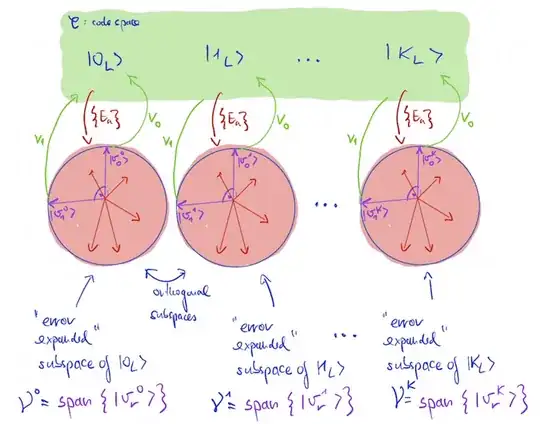

To add a visual aid to the great accepted answer I drew an image after reading the KL paper, I hope this helps.
At the top we have the green box showing the codespace $\mathcal{C}$ for a code that satisfies the KL conditions for $\{E_a\}$ error operators (red arrows). We can map each $|i_L\rangle$ logical basis state to the "error-expanded subspaces" $\mathcal{V}^i$ (red disks) that are spanned by the $E_a|i_L\rangle$ (red vectors in the red disks).
The $\langle i_L| E_b^\dagger E_a |i_L\rangle = \langle j_L| E_b^\dagger E_a |j_L\rangle$ statement means that the states that the errors map the states to are not necessarily orthogonal - but the key thing is that we have the same "angle" between the mapped vectors (as seen in the figure, the subspace disks are clones of each other), and thus that these error-expanded subspaces are isomorphic. The KL paper has a nice example where these corrupted states overlap for the same logical state. This just means that if we have, say, $M$ number of error operators that are correctable, then the dimension is at most $M$ of the error expanded subspaces, but it might be less than $M$. Also, the norm of the basis vectors might not be preserved under these error operations, they can shrink (I don't think they can grow under quantum channels). In the picture I have two dimensional error-expanded subspaces, with $|v_0^i\rangle, |v_1^i\rangle$ spanning each.
The orthogonality condition $\langle i_L| E_b^\dagger E_b |j_L\rangle = 0$ for $i\neq j$ is displayed in the image by no overlap between the subspaces.
It is interesting now to see how this picture leads to recoverability, so I'll provide the sketch of the KL-proof for these conditions being sufficient and necessary:
  • for each of the $\mathcal{V}^i$ we can find an orthonormal basis $|v_r^i\rangle$ (purple ones) - these are mutually orthogonal, across both indices
  • due to this orthogonality we can create a unitary recovery operator for each basis vector that maps them back to the original codeword, $V_r | v_r^i \rangle = |i_L \rangle$ - these are the green arrows on the cartoon with $V_0$ and $V_1$ mapping back from the corresponding error basis vectors to the codewords.
  • We can think about each $V_r$ as mapping to a copy of our codespace, in fact logical operators that map between $|i_L \rangle \rightarrow |j_L\rangle$ are going to map between $|v^i_r\rangle \rightarrow |v^j_r\rangle$. We can call these "copies" cosets (not displayed on the cartoon to avoid clutter, but you can see that the upward or leftward pointing purple vectors are isomorphic to the codespace).
  • at this point we're done, we just need to measure which orthogonal subspace the state is at i.e. are we in one of the cosets or in the remaining part of the Hilbert space (which means the codespace $\mathcal{C}$ and maybe some other parts) and then apply conditionally $V_r$.
