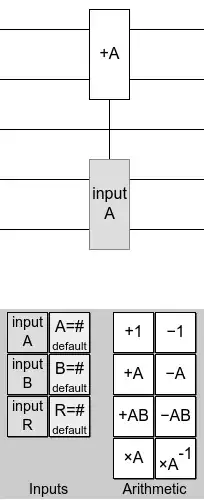

The input gates are in the bottom toolbox, near the center:
input gates
If you place an input gate in the same column as an arithmetic gate requiring that input, they will link together into a combined operation:
arithmetic combo
You can also precede the input-requiring gate with a classical setting of the value:
classical arithmetic
Separating the input and the target into separate boxes makes using arithmetic much more flexible than it otherwise would be. In an older version they were combined into a single gate, and it was just generally a giant hassle to get anything lined up.

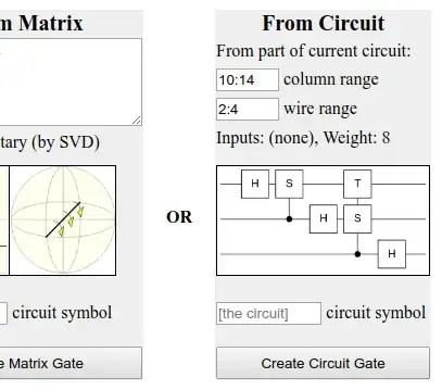

The "x499" gate in the circuit you linked is a custom gate:
Specifically, it is a "Circuit Gate" which was made by clicking the "Make Gate" button and then entering a range of the (at creation time of the gate) current circuit to include in the gate.
custom gate
Notice that there is in fact a series of custom gates in the before-last screenshot. Each is including a handful of copies of the previous one, in order to build up to many many applications of the "apply Hadamard and controlled increment" operation. This is a workaround for the fact that Quirk has no concept of a loop.
Be aware that custom gates are by far the weakest part of Quirk's user experience. They're clunky to make, impossible to delete without editing the URL, don't have large enough thumbnails... it's just something that I'd have to put 100 hours into to make it good and I haven't had the motivation.
