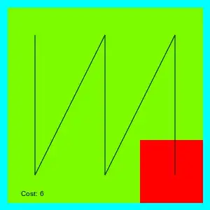

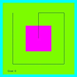

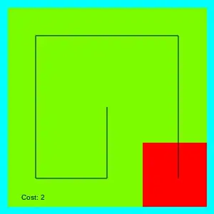

For a short background on protein folding, there are 4 letters in the RNA alphabet:
$$A, U, G,C$$
Each 3 consecutive letters from the RNA alphabet code for an amino acid, eg.
$$\{UUUACAGCU\}_{RNA} \rightarrow \{PTA\}_{amino-acid}$$
There are 20 amino acids that are standard in Earth biology,
$$A, R, N, D, C, E, A, G, H, I, L, K, M, F, P, S, T, W, Y, V$$
A "protein" is a long enough chain ($\gt 20$) of amino acids, eg.
$$\{ACDDGHHWYTSSPFENNNRST\}_{amino-acid} \rightarrow X_{Protein}$$
Quite remarkably, the same chain composition will fold into the same 3 dimensional shape most of the time (in similar external environment).
Misfolding of amino acid chains is thought to be responsible for some serious diseases (eg, Alzheimer's).
The adiabatic search space of a simple-model chain of only 9 amino acids (in 2 dimensions) is already
$$2^{81}$$
which is far beyond exhaustive classical optimizations.
enter image description here enter image description here enter image description here
