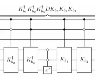

I'm implementing a quantum circuit in qiskit for a Szegedy quantum walk, (reference, Fig 21.). It uses two registers of dimension $N$ ($N=3$) each one. The challenges I'm facing are:
  1. Multiple controlled gates (2 and 3 controls and targets like $H$, $R_{y}$).
  2. Hermitian conjugate of an operator (Dagger).
  3. Ancilla qubits, that increase the complexity of the circuit.
Here is a main part of the circuit:
circuit

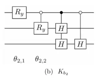

For example, we have $K_{b_{2}}$ controlled by zero and one controls.
This is the K_{b_{2} without dagger}

So, for $K_{b_{2}}$, I control individually all the gates as follows, is this approximation correct?
K_{b_{2}}
How do I control the $R_{y}$ gate? I could not find a Controlled rotation around Y-axis only for Z axis (crz).
qiskit
I would define for each gate of the above figure, the "compute-copy-uncompute" method here.
def kb2(qw, q0, q1, anc):
    qw.ccx(q0[0], q0[1], anc[0])
    qw.cry(np.pi/2, anc[0], q1[0])
    qw.ccx(anc[0], q1[0], anc[1])
    qw.cry(np.pi/2, anc[1], q1[1])
    qw.ch(anc[1], q1[1])
#... and so on
return kb2
q0 = QuantumRegister(3, 'q0') q1 = QuantumRegister(3, 'q1') anc = QuantumRegister(2, 'a')
qwcirc = QuantumCircuit(q0, q1, anc)
qwcirc.x(q0[1]) # for 0-control kb2(qwcirc, q0, q1, anc) qwcirc.x(q0[1]) #for 0-control
Matplotlib Drawing
qwcirc.draw(output='mpl')
I think half of the Toffoli's gates may be avoided...but I really hope to start a conversation. Thanks in advance.

Is the following proposal correct?
K_{b_{2}}
This is not an approximation: it is 100% correct. Controlling a composed-quantum gate is equivalent to controlling all the gates composing it (may be used recursively).
About the implementation of the $R_y$ gate, you can implement it with the circuit given here.
Implementation of the controlled-Ry gate
For multiply-controlled $R_y$ gates, you can apply this definition recursively.
A quick observation: you can remove the 3rd control from the last 2 $H$ gates. If the first 2 controls are verified, the $H$ gate will be applied only once to the last qubit, independently of the value of third control-qubit.
