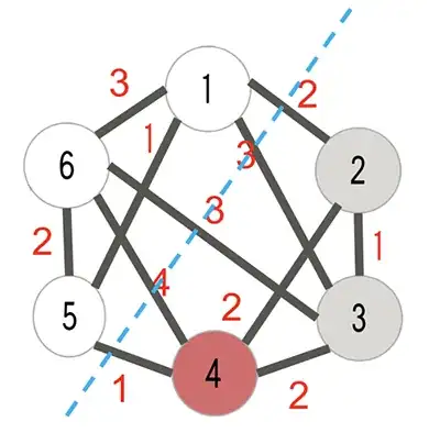

To understand the problem, we start with an undirected graph of $n$ vertices $\{V\}$, where each vertex $v_i\in V$ has weight $w_i\geq0$ and each edge connecting $v_i$ and $v_j$ has a weight $w_{ij}\geq0$. We then cut the graph into two pieces. The cut need not be straight but must not self-intersect and cannot cut any edge twice. Then we calculate a "payout" $P$ for our cut. The payout is the sum of the weights of the edges we cut through, plus the sum of the weights of the vertices on one side of the cut.$^1$
Sourceenter image description here
In this image, the payout would be, $1+4+3+3+2 = 13$ for the edges plus $5+6+1 = 12$ for the vertices $\to P=25$ (assuming the number inside each vertex is its weight). The optimization problem is to maximize $P$ for a given graph.$^2$
To write this mathematically, we can think in terms of bit strings. We define a cut by a string $s\in\{0,1\}^n$ where $s_i=0\to v_i$ is not counted in the sum and $s_i=1\to v_i$ is counted in the sum. To make the math a little cleaner, if the graph isn't fully connected, make the graph to be fully connected and set $w_{ij}=0$ for any unconnected pairs $v_i,v_j$.
For example, looking at the image above again, let's interpret the numbers inside the vertices to be the vertex index instead of the weight like we assumed above. Then the drawn cut corresponds to $s=100011$. $s_1=s_5=s_6=1\to v_1, v_5, v_6$ are on the "good" side of the cut and get counted, while $s_2=s_3=s_4=0$ are on the "bad" side of the cut and are not counted.
This then allows us to write $$P(s) = \sum_i s_i w_i + \sum_{i,j} s_i(1-s_j)w_{ij}$$
The first term just counts the weights of all the vertices on the "good" side of the cut. The second term counts the weight of an edge if the vertices it connects are on opposite sides of the cut. Note this doesn't double count since it only counts the edge when $s_i=1, s_j=0$ and not when $s_i=0, s_j=1$.
