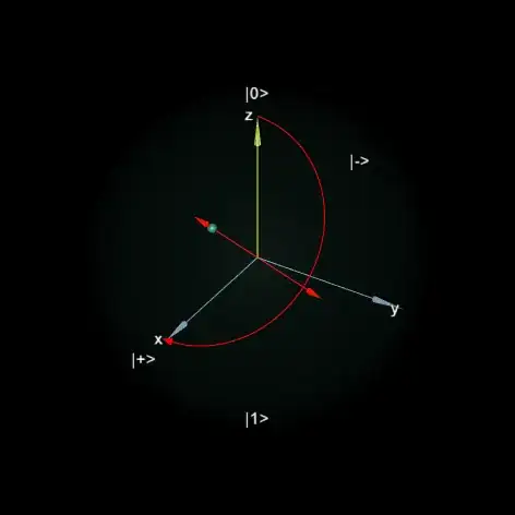

Let me plug my pet project: https://attilakun.net/bloch
It allows you to enter arbitrary 2x2 matrices and visualize how the quantum state is affected by them.
In the below example the red arc shows how the H matrix transforms the $|0\rangle$ state (yellow arrow) into $|+\rangle$:
Also, it's open source if you want to play around with the code: https://github.com/attila-kun/bloch
