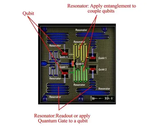

To my understanding, most of the qubits we use today are just Josephson junctions coupled to a resonator that is triggering the qubits to go to different states by using microwave pulses. The same resonators are also used to read the information form qubits. As shown in this picture:Quantum COmputer chip So I was wondering how does a qubit readout, when we measure it, gets read and how it is interpreted. How does raw information from qubit look like?

What follows turned out to be a rather technical explanation, so I'll start with the main point: The qubit state can change the resonator's state, and the resonator's state can be easily measured only if there is a large different in frequencies between the qubit and the resonator.
Let's model a qubit as a two-level system and a resonator as a harmonic oscillator. We need to give both a characteristic frequency, so let's call the qubit frequency $\omega_q$ and the resonator frequency $\omega_r$. We also need to characterize the strength of the interaction (how fast energy is transferred from one thing to another), and that's usually called $g$.

Now, if the frequencies of the resonator and the qubit are the same (that's called the "resonance condition"), then they will exchange energy back and forth, much like an LC circuit or potential and kinetic energy in a pendulum. That's not ideal for measuring a qubit (you want to avoid as much as possible the measurement apparatus influencing the qubit state), so we make the frequency of the resonator very far away from the qubit's. This is a called a dispersive interaction.
