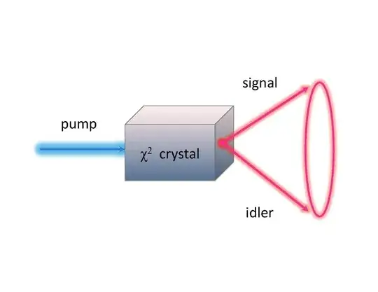

Due to the phase matching conditions, the emitted photon pairs will be emitted at opposite points on a cone, as shown below in Figure 1.
Type 1 SPDCFigure 1: A laser beam is input into two type 1 SPDC crystals, with orthogonal extraordinary axes. This results in a probability of emitting a pair of entangled photons at opposite points on a cone. Image taken from Wikipedia.
