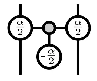

In answer to your first question, yes there is a way to build controlled-$H$ in ZX. It more or less mirrors the construction in quantum circuits. First, one can construct controlled-$Z$-phase gates using the technique described in the "Quantum Computing" chapter of mine and Coecke's book (Picturing Quantum Processes, p. 687):
controlled-Z phase
n.b. the white dots are $Z$-spiders, gray dots are $X$-spiders.

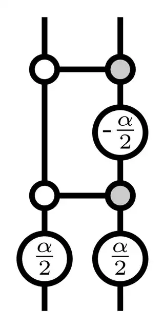

This is a controlled phase gate, which conditionally applies a $Z(\alpha)$ on the second qubit if the first qubit is $|1\rangle$. Using the bialgebra law, it is not too hard to show this is actually equivalent to a more familiar "circuit-like" form of the gate:
CZ circuit form

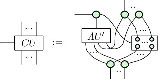

The easiest way to do this would be to use the general controlled unitary construction given in this post: Given a decomposition for a unitary $U$, how do you decompose the corresponding controlled unitary gate $C(U)$? translate the circuit to ZX and hopefully simplify the circuit using ZX rewrite rules to get a nicer expression.
First, there is a neat way of performing the controlled Hadamard, with only two occurrences of the $T$ gate:

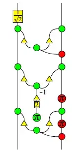

If you use the symbol of triangle and lambda box in ZX, see e.g. my paper with KangFeng Ng arXiv:1706.09877, then there are two simple ways of representing the CH gate in ZX-calculus, one of them even need not any decomposition of the H gate (diagrams should be read from top to bottom):
CH without decomposition
If you don't want any H showing in CH, then you have another diagram for CH: CH without H
From my experience, translating C(U) circuits into ZX usually is not an easy way for getting nice expression even after ZX simplification, if you don't know a nicer expression in advance.
