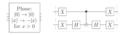

In the chapter about the Grover algorithm, it is suggested that the gate which executes the phase shift is given in the following form:
Now I have looked at this gate in detail and come to the conclusion that this "only" negates the state $|00\rangle$, but not all others, this can be shown for different inputs $|00\rangle$, $|01\rangle$, $|10\rangle$, $|11\rangle$ (the gate changes only $|00\rangle$ to -$|00\rangle$) or see here. I'm sorry, because in the chapter it says a few pages earlier: $|x\rangle$ becomes $-|x\rangle$ and $|0\rangle$ remains to $|0\rangle$ (picture left section). But that does not correspond to the circuit (picture right section). That's why I ask myself, what is right now? I want to do this a bit further, we say the Grover operator is:
$$H^{\otimes n}(2|0\rangle\langle 0|-I)H^{\otimes n}$$
That means I have several Hadamard transformations before and then do the phase shift, followed by Hadamard transformations. I think that you can see this in $(2|0\rangle\langle 0|-I)$ (matrix with 1 in the first row, all other rows -1), that $|x\rangle$ becomes $-|x\rangle$ and $|0\rangle$ stays $|0\rangle$. But that does not correspond to the circuit (picture right).

You are absolutely right. The picture in the right section correspond to the picture in the left section up to the unimportant global phase factor (-1). This fact mentioned in the Exercise 6.6.
The Box 6.1 use only one Grover iteration, so that $|ψ\rangle$ after this Grover iteration will be rotated to the (-$|x\rangle$) instead of $|x\rangle$ as in the general Grover algorithm. But this does not has any impact to the final result because the probability to find an $|x\rangle$ use the amplitude squire.
