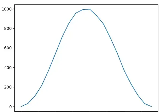

plt.plot([r.histogram(key=str(q))[1] for r in results])
plt.show()
rabi oscillation
