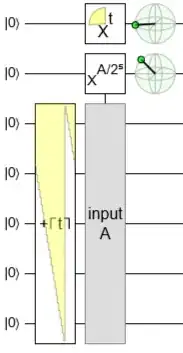

If that's acceptable, then the simplest way to achieve it is by using the parameterized rotation gates and a counting gate:
circuit
An alternative trade-off do is define double-speed rotations by using pairs of time-dependent rotation gates, and then work in units of $2t$ instead of $t$. You can use custom circuit gates to fuse them into a single block. If custom gates annoy you (they are by far the weakest part of the UX), the time-dependent gradient gate gives you a series of faster and faster rotations:
gradient gate
