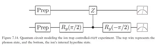

The circuit is as shown (Source: Nielsen and Chuang, pg.323) (Source: Nielsen and Chuang, pg.323)
The Control-Z is what the $2\pi$ pulse is in the second step.

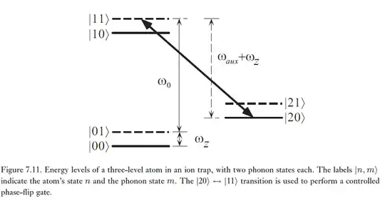

If you follow this scheme of Nielsen and Chuang (sec-7.6.4), the $2\pi$ pulse implements this operation as follows: enter image description here
We need to switch $|01\rangle \leftrightarrow |10\rangle$ for the control-Z. This is done as follows. We need a way to swap qubits between the atom’s internal spin state and the phonon state (little perturbation over the spin states). This can be done by tuning a laser to the frequency $\omega_0-\omega_z$, and arranging for the phase (which can always be done by the laser) to be such that we perform the rotation $R_y(\pi)$ on the subspace spanned by $|01\rangle$ and $|10\rangle$, which is just the unitary transform
\begin{equation} C_{SWAP}=|00\rangle \langle 00|+|01\rangle \langle 10|-|10\rangle \langle 01|+|11\rangle \langle 11| \end{equation} on the $|00\rangle, |01\rangle, |10\rangle, |11\rangle$ space. If the initial state is $a|00\rangle + b|10\rangle$ (that is, the phonon is initially $|0\rangle$), then the state after the swap is $a|00\rangle + b|01\rangle$, so this accomplishes the desired swap operation, which is the second step in Cirac-Zoller. Note here that $2\pi$ pulse is just the $R_y(\pi)$ here which is equivalent by just a convention.

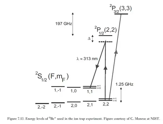

The frequency notation is explained in the last image.
I would suggest to read thoroughly the section 7.6 of Nielsen and Chuang to make a complete understanding. enter image description here
