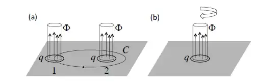

The spin-statistics theorem requires a particle's wave function to acquire the same phase when it is rotated by an angle of $2 \pi$ about itself and when exchanged with an identical (indistinguishable) particle. For example, a fermion acquires a phase of $-1$ both in exchange and self-rotation.
Thus, when we think of an anyon as a flux-charge entity, we have to think of it also as an extended object having an inner structure of a spinning body, or equivalently, when it rotates about its axis, its own charge rotates around its own flux.
The self-rotation explains the doubling of the topological phase of the anyon molecule.
This property is explained, possibly more clearly, by Pachos, (sections 2.1.2 and 4.1.6). The following figure explains the phase acquired in self-rotation is taken from section 2.1.2:
Pachos description of the figure:
(a) Anyons can be described effectively as composite particles with an attached magnetic flux, and a ring with electric charge, $q.$ When anyon 1 moves around anyon 2 along loop $C$ its charge circulates the flux of the other anyon and the Aharonov-Bohm effect gives rise to a non-trivial statistical phase.
(b) When the composite particle rotates around itself by $2\pi$ it again acquires a phase factor as its charge circulates its flux, which can be attributed to a spin.
