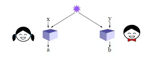

In the CHSH game we have 2 players Alice and Bob. Can we proof in the form of a noncommunication pair of TMs which takes as input independant random bits x and y plus an arbitrary shared bitstring, that ALice and Bob win the CHSH game with probability greater than 75%.
We ask Alice and Bob questions x and y with probability p(xy) they give answers a and b. The rules of the game are denoted using $V(a,b|x,y)$wich takes the value "1" if a and b are the winning answers. The probability that Alice and Bob win the game is maximized over all possible strategies $ P_{win} = max_{strategy} \sum_{x,y} p(x,y) | \sum_{a,b} V(a,b|x,y) p(a,b|x,y). $ Where $p(a,b|x,y) $ is the probability that Alice and Bob produce answers a and b given x and y.
Test setup
In terms of probabilities there is an distinction between a classical deterministic prob and a classical shared ramdoness probability. A deterministic classical stratey is given by the functions $f_{A}(x) = a$ and $f_{B}(y) = b $ that take the questions x and y.
If we have shared randomness another string r is used with a sharing probability $p(r)$. Classicaly Alice and Bob can only apply functions $a = f_{A}(x,r)$ and $b = f_{b}(y,r)$ This gives $ p(a,b|x,y) = \sum_{x,y}^{} (p(r)) p(a,b|x,y,r) $ In this case the pobability of winning the game is
$ P_{win} = max_{strategy} \sum_{x,y} p(x,y) \sum_{a,b} V(a,b|x,y)\sum_{r}p(r)p(a,b|x,y,r)$. In this case of shared randomnes we have an extra term with the string r. Alice and Bob can fix the best possible r given a deterministic strategy for a and b. So it is possible to run an algorithm on a Turing machine using a string r according to the test setup in the picture. Problem how do we find the best possible string r?

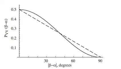

Another way to look at it is to say that the string r as a shared randomness is referred to as a hidden variabele in physics. So the Hidden Variabele Theory is equivalent to using a string r in a turing machine. Therefore we might just as well make use of a proof of the CHSH inequality. Furthermore we can compare an arbitrary HVT (dashed line ) and QM results for a photonic experiment. enter image description here
A compact proof of the CHSH inequality based on a hidden variabele can be found in the article Entangled photons, nonlocality and Bell inequalities in the undergraduate laboratory.
