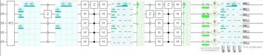

Grover with W5 state and standard diffusion
Here is another example with a W5 state selecting $$|00010\rangle$$ while rotating around $$|00001\rangle$$. enter image description here
As we can see, in both cases the standard diffusion selects the right amplitude with a not so huge probability
