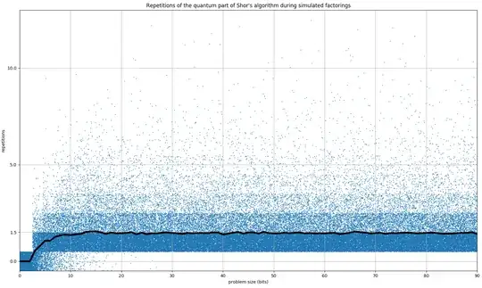

I also did some simulation of how many repetitions are needed when the two factors are similarly sized primes, using some basic post-processing, and it appears to converge to 1.5. The following plot is showing a blue dot for each factoring attempt, with a random +-0.5 on each dot's X and Y position so you get a sense of the density in each area. The thick black line is the average.
plot
