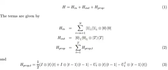

As for a verifier being able to reduce things to 2 local Hamiltonian, this is also yes. This picture is from 3-Local Hamiltonian is QMA Complete, and constructs a 3-Local Hamiltonian entirely from projections and $U_i$'s. As the various $U_i$'s are efficiently representable classically (and I assume projections onto the computational basis are as well), it appears a $\mathsf{P}$ machine should be able to construct the local Hamiltonian efficiently (given the classical description of $U_x$, likely with respect to a fixed universal gate set).
Note that the below construction is for 3 Local Hamiltonian, and while the construction for 2 Local Hamiltonian is more technical, I see no difficulties in extending the above argument.
