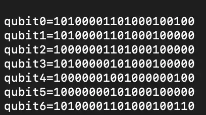

After this, I then pass all of the $j$ qubits through the inverse quantum Fourier transform. The outputs I'm getting seem kind of strange:
(This is all $7$ of the $j$ qubits measured for $20$ iterations of the circuit).
I was just wondering if anyone had any insight, since I feel as though I made some kind of mistake in creating the unitary.

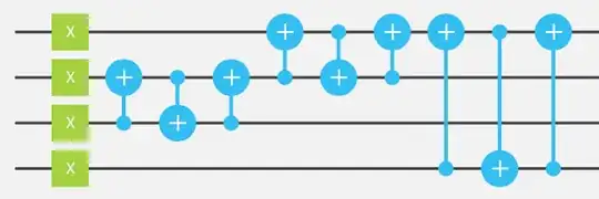

You can test stand alone the a modular multiplication circuit. In this case $\text{base} = 2$ and $N = 3$. However the smallest useful composite $N = 15 = 3 \times 5$.
Let's take a well known Multiplication by 7 modulo 15 circuit
We start with input $$\ |1\rangle \text{ gives } |7\rangle$$ $$\ |7\rangle \text{ gives } |4\rangle$$ $$\ |4\rangle \text{ gives } |13\rangle$$ $$\ |13\rangle \text{ gives } |1\rangle$$ This repeats after $4$ times and the period = $4$
In the not so useful case of $N = 3$ and $a = 2$
$$1 \times 2 \text{mod} (3) = 2$$
$$2 \times 2 \text{mod} (3) = 1$$
It repeats after $2$ times. Period is correct $2$ and can be tested in a quantum simulator.
