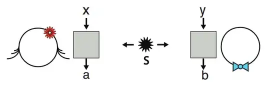

Continuing from my previous (1, 2) questions on Brunner et al.'s paper (arXiv) on Bell nonlocality. Again, we have the following standard Bell experiment setup:
where independent inputs $x,y \in \{0, 1\}$ decide the measurement performed by Alice & Bob on quantum state $S$ with outcomes $a,b \in \{-1, 1\}$. We say $a$ and $b$ are correlated (not independent) if: $P(ab|xy) \ne P(a|x)P(b|y)$ which is a lazy physicist's way of writing: $$P[A = a \cap B = b | X = x \cap Y = y] \ne P[A = a | X = x] \cdot P[B = b | Y = y]$$ where $A, B, X, Y$ are discrete random variables and $a,b,x,y$ some specific elements from the sets defined above. I wanted to check this basic (in)equality with some simple example values, so I considered the following:
