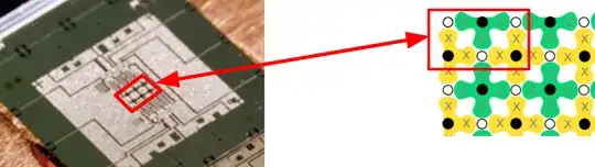

is the common depiction of a surface code (the pattern of the measure qubits and data qubits) to be taken literally as a real-space image of the actual hardware?
Correct. The surface code is physically implemented by a planar grid of qubits.
hardware vs diagram
Left image source
are surface codes still a theoretical framework due to the massive amount of qubits that are needed?
Correct. To do error corrected quantum computation you need on the order of a thousand physical qubits per logical qubit. And your physical qubits must have fewer than 1 error per thousand operations (especially the 2-qubit operations). No one has a hundred physical qubits yet, and the best demonstrated error rates are ~5 in a thousand.
