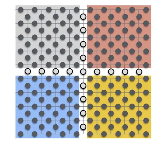

One can use fragments of the plane to store qubits. The image below shows four qubits which are encoded as part of a larger lattice: the light dots with black outlines are qubits which are not involved in the encoded qubits, and can in principle be in any state that you like, unentangled from the rest.
$\qquad\qquad\qquad$
In each of these fragments, the qubit is defined by the stabiliser relations which (ideally, in the absence of errors) hold among the qubits. For surface codes with the sorts of boundary conditions illustrated here, these are either 3-qubit X or Z stabilisers around the boundary, and either 4-qubit X or Z stabilisers in the 'bulk' or body of the code. The pattern of these stabilisers is illustrated below. Note that each X stabiliser that overlaps with a Z stabiliser, does so at two qubits, so that they commute with one another. (Apologies for the image size: I cannot manage to get it to display at a reasonable size.)

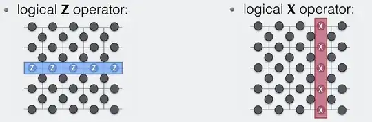

There are a number of (tensor product) Pauli operations which commute with all of these stabilisers. These may be used to define logical Pauli operators, which describe ways in which you can both access and transform the logical qubits. For instance, a product of Z operators across any row from boundary to boundary will commute with all stabilisers, and can be taken to represent a logical Z operator; a product of X operators across any column from boundary to boundary can similarly be take to represent a logical X operator:
$\qquad$
It doesn't matter which row or which column you use: this follows from the fact that a product of any two rows of Z operators, or of any two columns of X operators, can be generated as a product of stabilisers and therefore realises an identity operation on the encoded qubit (as the stabiliser generators themselves are operators which perform the identity operation on an encoded qubit state, by definition). So: if you want to apply an X operation to an encoded qubit, one way to do so would be to apply such a logical X operation, by realising X operators on each qubit in a column reaching between two boundaries.**

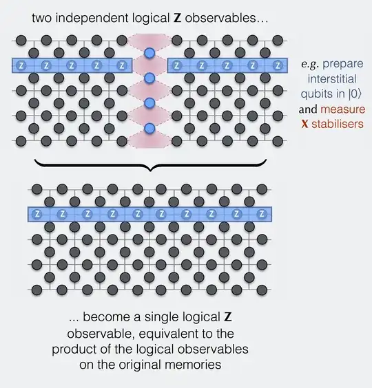

To realise a two-qubit operation, you can use a technique known as lattice surgery, wherein you 'merge' and 'split' different patches of the 2D lattice to realise operations between those patches (see [arXiv:1111.4022], [arXiv:1612.07330], or [arXiv:1704.08670] for complete descriptions of these operations. Disclosure: I am an author on the third of these articles.) This may be realised between two adjacent patches of the planar lattice (as illustrated above) by preparing those "uninvolved" rows and columns of qubits in a suitable state, and then measuring stabilisers which previously you were not measuring in order to extend the memory to a larger system. (In the diagram below, the horizontal spacing between the code segments and the column of qubits in the |0〉 states is exaggerated for effect.)
$\qquad$

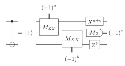

This will affect the logical operators of the system in a non-unitary way, and is most often used (see [arXiv:1612.07330] for example) to realise a coherent XX or ZZ measurement, which can be composed to realise a CNOT operation [arXiv:1612.07330, Fig. 1(b)]:
In this way, you can realise a CNOT operation between a pair of encoded qubits.***

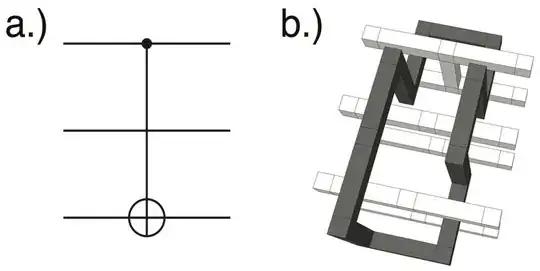

There are two different types of hole, depending on whether the boundary of the hole travels along would-be X measurement qubits or along would-be Z measurement qubits. A CNOT is performed by cycling a hole of one type around a hole of the other type.
Diagrammatically speaking, it looks like this:
In the (b) diagram, time is moving from left to right. Each bar corresponds to the location of a hole over time. Each qubit is stored between the corresponding pairs of white bars. The black bar represents the hole being used to perform the CNOT. It avoids the middle qubit (which is not involved), surrounds one of the bars of the bottom qubit (which is the target), and goes around a 'cross-bar' introduced into the top qubit (which is the control). That's what a surface code CNOT looks like.

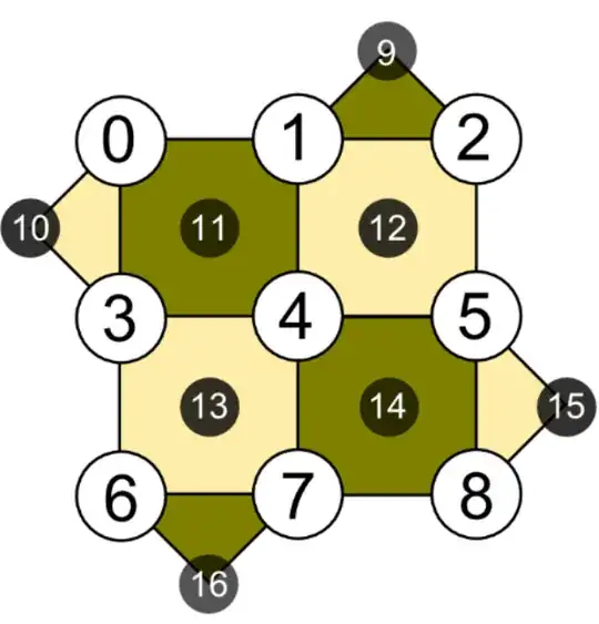

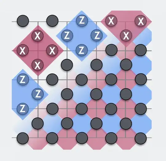

For a concrete example, let's take the 17 qubit surface code shown below (as depicted in this paper, of which I am an author).
This is made up of $n=9$ physical qubits, numbered from $0$ to $8$. There are also 8 ancilla qubits depicted here, but we'll ignore them.
The dark patches in this image denote stabilizers made of $\sigma_x$ (so we measure the observables $\sigma_x^0 \otimes \sigma_x^1 \otimes \sigma_x^3 \otimes \sigma_x^4$ and $\sigma_x^1 \otimes \sigma_x^2$, for example). The light patches are then the $\sigma_z$ stabilizers.
One example of an operation that commutes with all stabilizers is to do a $\sigma_x$ rotation on a line of qubits from top to bottom, such as $\sigma_x^0 \otimes \sigma_x^3 \otimes \sigma_x^6$. Another example is to do a line of $\sigma_x$ rotations from left to right, such as $\sigma_z^3 \otimes \sigma_z^4 \otimes \sigma_z^5$.
All other operations that commute with the stabilizer will be either products of stabilzers themselves (and so act trivially), or they will be equivalent to one of these two examples. So these operations act on our logical qubit. Since one is made of $\sigma_x$s, the other is made of $sigma_z$s, and they anticommute, it is would seem sensible to assign them as the Pauli operators $X$ and $Z$ of the logical qubit
$$X = \sigma_x^0 \otimes \sigma_x^3 \otimes \sigma_x^ 6, Z = \sigma_z^3 \otimes \sigma_z^4 \otimes \sigma_z^5$$
So to do an $X$, you just perform the operation above.
