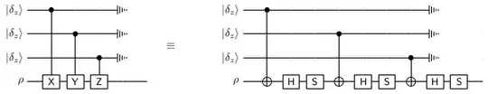

    We are going to use three qubits to trigger independent events. These events are acting on the input with an $\mathcal X$ channel, acting on the input with a $\mathcal Y$ channel, and action on the input with a $\mathcal Z$ operation, in sequence. Because the events are independent, it may be that more than one of them occurs. This is something we have to take into account in order to simulate the distribution $(1\!-\!\tfrac{3p}{4},\,\tfrac{p}{4},\,\tfrac{p}{4},\,\tfrac{p}{4})$ of Pauli operations to be applied — because the event of [apply $\mathcal X$, don't apply $\mathcal Y$, then apply $\mathcal Z$] has the same net effect as [don't apply $\mathcal X$, apply $\mathcal Y$, and don't apply $\mathcal Z$], and we would like to have the correct probabilities of having each possible net effect. By symmetry, we can infer that we would like to have the same probability $z$ of each of the effects to occur, so we would like to solve the equation $$ \tfrac{1}{4}p = z(1-z)^2 + z^2(1-z) = z-z^2 $$ For any $0 \leqslant p \leqslant 1$, there should be a unique $0 \leqslant z \leqslant \tfrac{1}{2}$ which solves the above equation. Subject to that value of $z$, we define the state $$ \ket{\delta_z} = \sqrt{1-z\;\!}\;\! \ket{0} + \sqrt{z}\;\! \ket{1}.$$ We then prepare three copies of this state to use effectively as a source of randomness, albeit involved in coherently controlled operations which determines whether the input qubit is subject to an $X$, $Y$, or $Z$ transformation. The circuit conveying the main idea is the following one on the left (with the circuit on the right describing how it would be realised in terms of the usual set of Clifford gates):
    quantum circuit to simulate depolarisation noise
    The symbols at the end of the top three wires are 'trace out' operations, and in effect mean 'ignore anything that happens to this qubit from now on'. (You could measure the qubits and simply ignore the result if you like, though to get the result of the depolarising channel it is important that you actually do ignore the outcomes of those measurements, as the transformation that occurs conditioned on any particular outcome will be not a depolarising map but a particular Pauli transformation.) The three instances of $H$ followed by $S$ in the right-hand circuit realises the Clifford operation which permutes the Bloch sphere axes $X \to Y \to Z \to X$, allowing us to simulate the different controlled Pauli operators via cyclically changing the reference frame on the input qubit.
