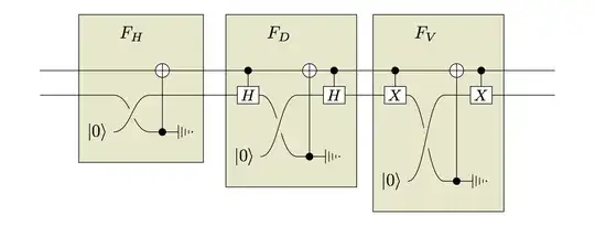

Simulation with a circuit using qubits
There are a number of different ways in which we could simulate this using qubits. A good choice of representation of the 'photon qutrit' will give us a simpler circuit. I would suggest the following.
  • Use a two-qubit representation with qubits labelled $N$ (for number') and $P$ (for 'polarisation'), where we consider $\ket{0}_P$ to correspond to horizontal polarisation (or the lack of polarisation when there are no photons) and $\ket{1}$ to correspond to vertical polarisation. Then $$ \ket{\varnothing} \equiv \ket{0}_N\ket{0}_P\,, \quad \ket{H} \equiv \ket{1}_N\ket{0}_P\,, \quad \ket{V} \equiv \ket{1}_N\ket{1}_P\,. $$ The two-qubit state $\ket{01}$ is not in the state-space of the simulation; by asserting that it is not valid as an input, we may use a simpler circuit.
  • The action of each filter can be described in terms of forcing a particular polarisation at output, for instance by mapping the polarisation to be selected for the $\ket{0}_P$, conditioned on the photon number being $\ket{1}_N$; preparing a fresh qubit in the state $\ket{0}$ and substituting it for the polarisation qubit; forcing the photon number to zero for the part of the state where the photon polarisation is not what we were selecting for; and then by discarding the information about the input polarisation and restoring the frame of reference for the polarisation.
Using this representation, the following circuit then represents the set-up of having all three filters present:
qubit circuit representing three-polarisation-filter experiment
(I've used a 'controlled-X' gate for the $F_V$ filter to emphasise the similarity to the $F_D$ filter: in general one can define a filter using any controlled unitary $U$, where $U$ determines the polarisation to filter.)
The symbols at the end of the 'auxiliary' wires for each filter is just a map of discarding that qubit (i.e. you don't care about anything at all that happens to it from that point on and it isn't accessible for measurement). This is equivalent to using a destructive measurement, summing up the non-normalised density operators for the two measurement outcomes, and then forgetting the measurement outcome, but from a physical perspective, you don't usually have to measure a qubit — or a photon, or your carry-on luggage — in order to forget about it and then lose access to it forever.
