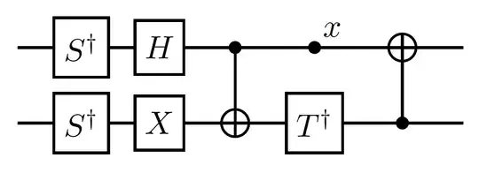

The circuit that I came up with is: enter image description here up to a global phase factor of $-e^{i x/2 + i \pi/4}$. The phase gate "x" that I used is essentially $R_z(x/2)=V_1(x)$ up to a global phase factor, so this is directly applicable to the first gates set. There's some possibility to move around some of the single-qubit gates, but I think this option minimises the depth of the circuit, which may be a more relevant number than the absolute number of gates, as it's more related to the time a circuit would take to implement (and hence how susceptible to noise it might be). Of course, I don't pretend that all gates would take the same length of time, and that's a completely different set of rules that one would be optimising over.

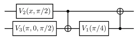

This same circuit can be rewritten using the other gate setenter image description here
To come up with this decomposition, I didn't use any particular method beyond the standard "I stared at it for a long time" technique. I then wrote down a circuit which was always going to be sub-optimal (including a swap gate, and a two-qubit diagonal gate with arbitrary phases on the diagonal), but then rearranged the circuit to bring some elements together so that they cancelled.
