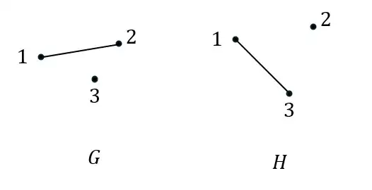

We will try to apply this approach to two labeled graphs $G$ and $H$ on three vertices as below. We wish to quantumly test whether these graphs are isomorphic, by preparing two states $|G\rangle$ and $|H\rangle$ corresponding to the uniform superposition of all permutations of $G$, respectively $H$. We'll see what happens when we do a SWAP test therebetween.
Two graphs on three vertices
Let's go in order; we'll begin with graph $G$, and then later work on graph $H$. At the end we will see what happens when we SWAP them.

  2. Lining up the matrices or alternatively lining up the permutations and taking the dot product lets us visually see that $\langle H|G\rangle=0$. Thus, the SWAP test between $|G\rangle$ and $|H\rangle$ won't tell you anything!
