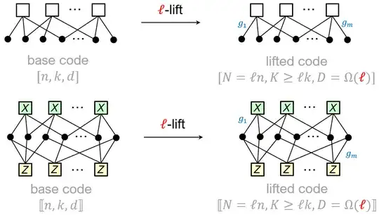

One of the biggest misconceptions about quantum lifted product (LP) codes, unfortunately quite widespread, and I feel personal responsibility for this, is to think about them as some kind of product construction, i.e., combining two or more codes with good properties in a hope to get codes with good properties, like it happens with hypergraph product (HGP) codes. Though, formally, LP codes $\mathrm{LP}(A,B^\mathrm{T})$ are essentially just non-binary HGP codes, where the matrices $A$ and $B$ are over the ring $R=\mathbb{F_2}[G]$ instead of the field $\mathbb{F}_2$, the way this construction breaks the $\Theta(N^{1/2})$ barrier and attains linear distance $\Theta(N)$ is significantly different, and has nothing to do with the idea of combining codes of large distances (or other good properties). In fact, the main reason why we chose the name lifted product was to emphasize that it is not a traditional product construction, where you get good parameters out of the good parameters of the component codes, but rather a new general way to lift the HGP codes, or, in topological terms, construct $\ell$-fold coverings for Cartesian product of graphs.
For a classical $[n,k,d]$ code defined by a Tanner graph $\mathcal{T}$, the lifted code defined by its $\ell$-lift $\mathcal{T}^{\alpha}$ has no guarantees to have a large distance; however, on average, a random $\ell$-lift does usually give you the code with the parameters $[N = \ell n, K \geqslant \ell k, D = \Omega (\color{red}{\ell})]$, provided that the permutations you assign to the edges of $\mathcal{T}$ come from a non-abelian group $G$ admitting good bounded-degree expanders (e.g., $\mathbf{S}_\ell$ or $\mathrm{PSL}(\mathbb{F}_q^t)$). LP codes are just a natural extension of this idea to higher dimensions, where instead of lifts of Tanner graphs, we use lifts of Cartesian product of Tanner graphs (i.e., lifts of HGP codes), and if we lift using a non-abelian group admitting good bounded-degree high-dimensional expanders (HDXs), then we still enjoy linear scaling of the distance (see the picture below).
lifts of classical and quantum codes
